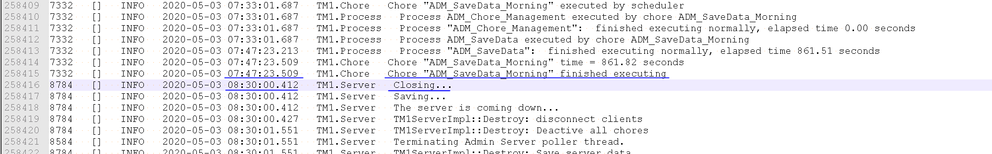

A stupid question but you do have a SaveData chore executing before your batch file takes down the TM1 service, right? If you don't it will save the data during the takedown, which can take a while if the service has been up for a long time. Maybe this is why it works fine with the extra timeout.

tomok wrote: Mon May 04, 2020 11:40 am A stupid question but you do have a SaveData chore executing before your batch file takes down the TM1 service, right? If you don't it will save the data during the takedown, which can take a while if the service has been up for a long time. Maybe this is why it works fine with the extra timeout.
In practice, quite a few people were faced with situations when the server simply could not repay without forcing the process to stop (taskkill / f), this happens if executecommand was started which did not end or if a big view was opened and the server issued a message about its suspension.
but as I understand the problem is broader than those windows event shows that the service is stopped? or in the process of stopping?
Hi Tom,
There's a savedata at 7.30 AM and it takes about 30 min usually. It's a daily chore. I will look in the server message log to see when then the save data stopped that morning. It could be that it clashes with the restart. Maybe because we went to summertime end of March... The restart is at 8.30 AM but this sounds like a possibility to check out !

No, the Savedata was successful and surely before the restart. This was the situation last Sunday morning:
That will not be the problem either.
