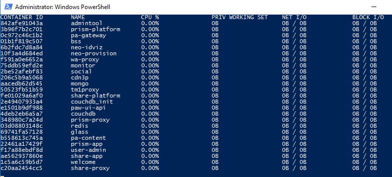

I have also tried stopping and restarting Docker from Services and also the great fail safe that is restarting the server (which is a VM).
Also when I run docker stats. it just shows a list of 0b and 0 cpu activity.
- Capture.PNG (31.11 KiB) Viewed 12872 times
