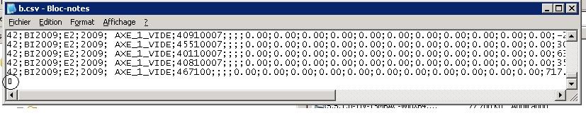

I've tested the script via the dos window and whilst I can get a second copy of the file created, the copy still has the end of file marker.
eof marker.JPG (48.29 KiB) Viewed 10127 times
So I'm still with no solution, anyone have an idea? Maybe I'll finally look at a perl book....
