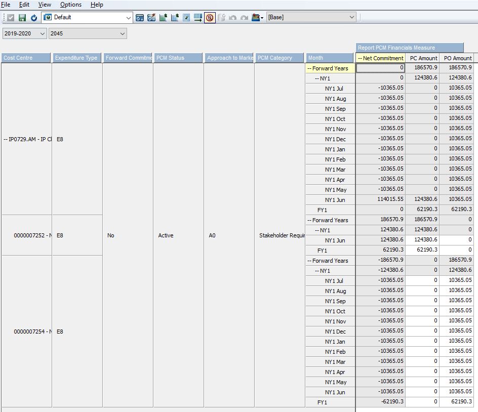

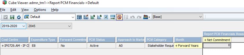

Re: Consolidation sum error - negative weighting
Thankyou for your comments so far, but I do not believe they have hit the nail on the head.
Took formatting off, some screen shots attached.
I have since noted that in the Month dimension, I was using Whole of Life, which is made up of opening balance (N) but $0, Year (with Months as children), and a consolidation for Forward Years.
The issue is at the Forward Years consolidation level where the issue appears, but you will see, esp in last screen shott, that its children are $0.
Although the highlighted cell shows 0, it actually is not 0. it is 0.00000000005821... when exported to excel, but also as zero suppress is on, it should not show if it is actually 0

- Steve Rowe
- Posts: 2467
You probably need to read up on floating point arithmetic.
https://en.wikipedia.org/wiki/Floating-point_arithmetic
Basically this means that even if mathematically / logically something should net to 0 it sometimes won't due to the very small inaccuracies introduced by converting a decimal value to binary and back again.
So if you want your accuracy to be 2 d.p. then round any ruled values, but even this might cause a zero suppression failure occassionally.
I seem to remember there is cfg setting in this area but my googlefu is off the boil....
