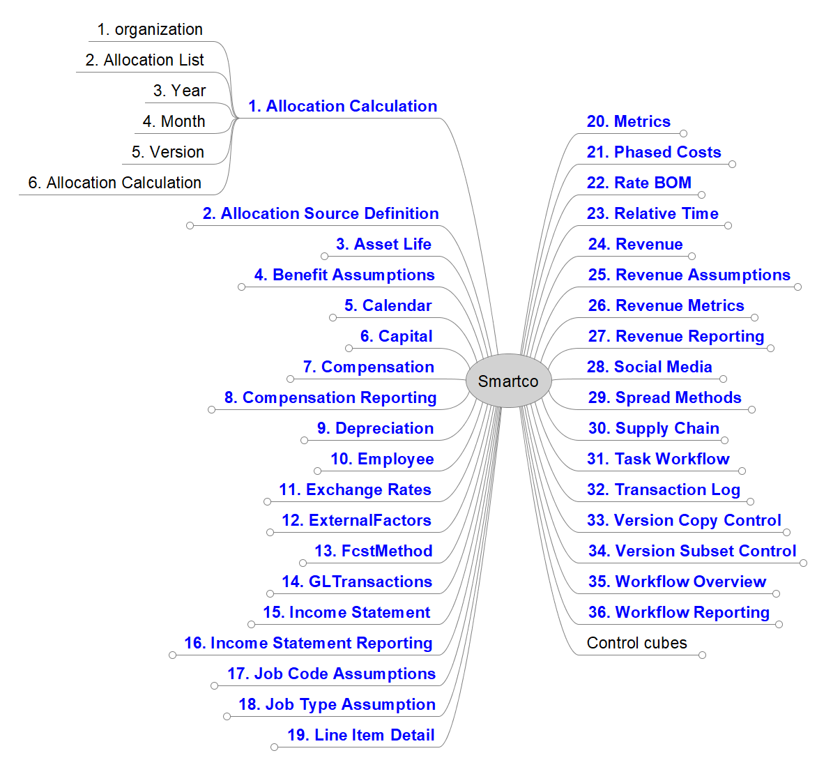

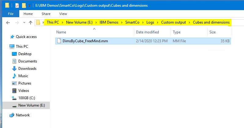

If you want to present cubes and their dimensions into a FreeMind visualization, the below TI process code can easily generate the *.mm file.
An example of such visualization is as follows:
TECH_TI to FreeMind.pro
(7.55 KiB) Downloaded 1249 times
