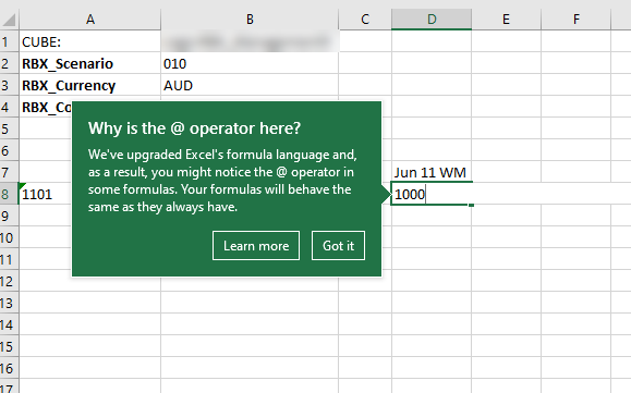

I created an active form using Excel for Office 365 version 16.0.12527.20260 32 bit. None of the formulas had an @ sign.
I manually changed one of the DBRW formulas in a slice to use the @ sign. When I went to type over it I got this:
If I may misquote a line from Casablanca, "I'm shocked, SHOCKED to find that gambling is going on in here and that Microsoft has lied again."
"Your formulas will behave the same"... not so much, no. As you say, entering a value just writes over the formula now.
I've seen posts in the Microsoft Communities indicating that this is an issue for a lot of UDFs (User Defined Functions) which are essentially what tm1.xla add-in formulas are.

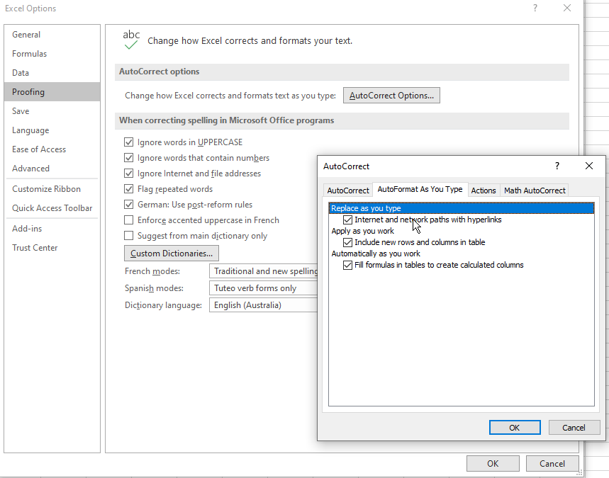

I recommend everyone to turn off the automatic formatting of URLs and email in their excel proofing settings. This is just one more reason to why.

Steve Rowe wrote: ↑Fri May 22, 2020 3:34 pm @Bakkone, must have missed this option, I did look, I'll look harder!
You know how MS likes to make life easy for you! They haven't buried it more than a couple of levels deep.
Options -> Proofing -> Auto Correct Options -> AutoFormat As You Type tab.
I do actually find this option useful more often than not for web links rather than addresses, but this is one in, all in.
