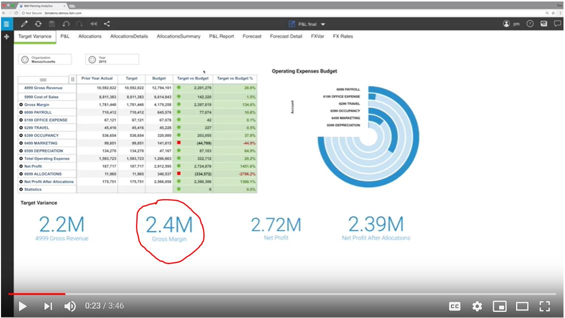

does anybody know, how is this PAW visualization feature called (pls refer to red colour in the screenshot)? I tried to find it in "what's new in PAW" IBM documentation but wasn't successful:

- paw feature.JPG (81.83 KiB) Viewed 4643 times
- Posts: 1833
Re: PAW visualization feature
That’s just a case of selecting a given cell from an existing cube view and right click - Add to Sheet. Or similar wording to that effect.
You can get this result if you right-click a cell in a crosstab, then choose 'Add to sheet'.
In the properties, it's possible to summarize the value to only K or M values, for example.
@declanr, @Wim Gielis, thank you a lot for the prompt reply! The information was exactly I was looking for!
