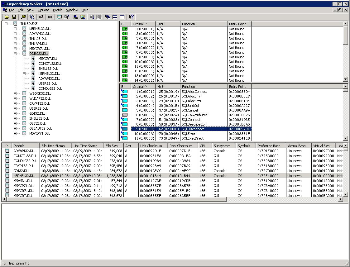

I installed an application called Process Explorer on the TM1 server. There is a function that shows the dependent DLL's for the tm1sd.exe service. Below is the DLL dependency list for the tm1sd.exe service:
There is an ODBC32.DLL that has a Function "SQLDisconnect" that is highlighted. I had a thought that perhaps it might be this driver that is causing the issue. I'm know that the VBA for TM1 is protected, so there's probably no chance of altering that. The other thought is that there would be something on the TM1 configuration file, but the only ODBC configurations I saw on the guide was for TM1 installed on a UNIX machine.
