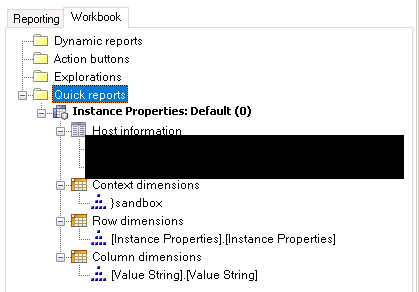

It may have dropped off in later releases of PAfE...at one time you could change the MDX subset references to reference a hierarchy for example and I assume to any valid MDX.
Pafe QuickReport.png (7.51 KiB) Viewed 21528 times
I don't seem to be able to do it now though, which is a shame as it was one of the few ways you could get to a hierarchy in Excel (COUGH COUGH COUGH *LUNG*).
Credit for the original tip to Ryan D Clapp.
