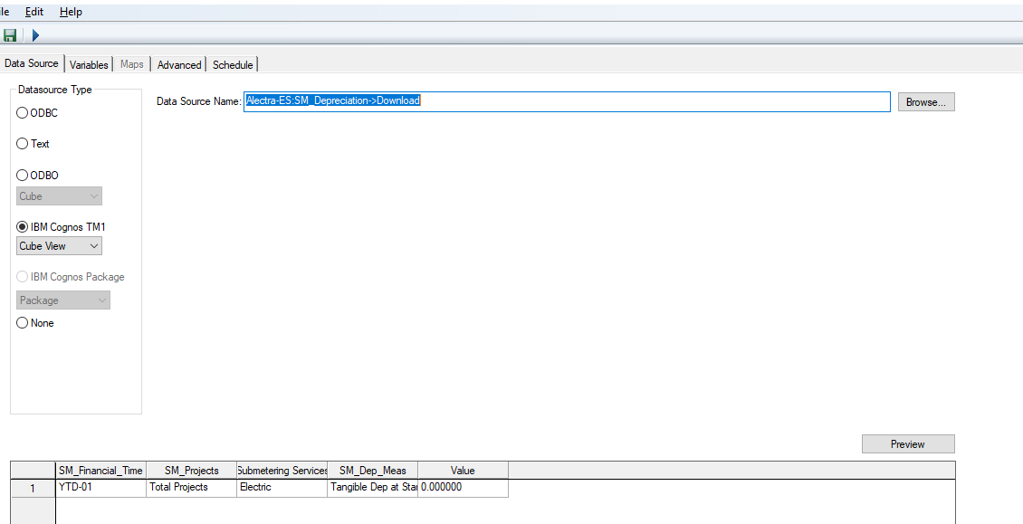

I keep getting process aborted error message (file A:\filename.csv not found)...sorry somehow I couldn't attach more screenshots...
Can someone please help?
DataSource is Cube View
Data Source Name: I chose a cube view named "Alectra-ES:SM_Depreciation->Download"
in Variables I have:
vTime
vProject
vtype
vMea
Value
in Parameters I set up pExportName as string with question "Enter File Name"
in prolog I have:
vCount = 1;
FilePath = 'A:\';
in Data I have:
If(vCount =1);
ASCIIOUTPUT(FilePath | pExportName | '.CSV', 'Period', 'Project', 'Type', 'Measure', 'Value');
vCount = 2;
EndIf;
ASCIIOUTPUT(FilePath | pExportName | '.CSV', vTime, vProject, vType, vMea, NumberToString(Value));
thanks so much!
vTime
vProject
vtype
vMea
Value
in prolog I have:
vCount = 1;
FilePath = 'A:\';
in Data I have:
If(vCount =1);
vCount = 2;
EndIf;
thanks so much!
