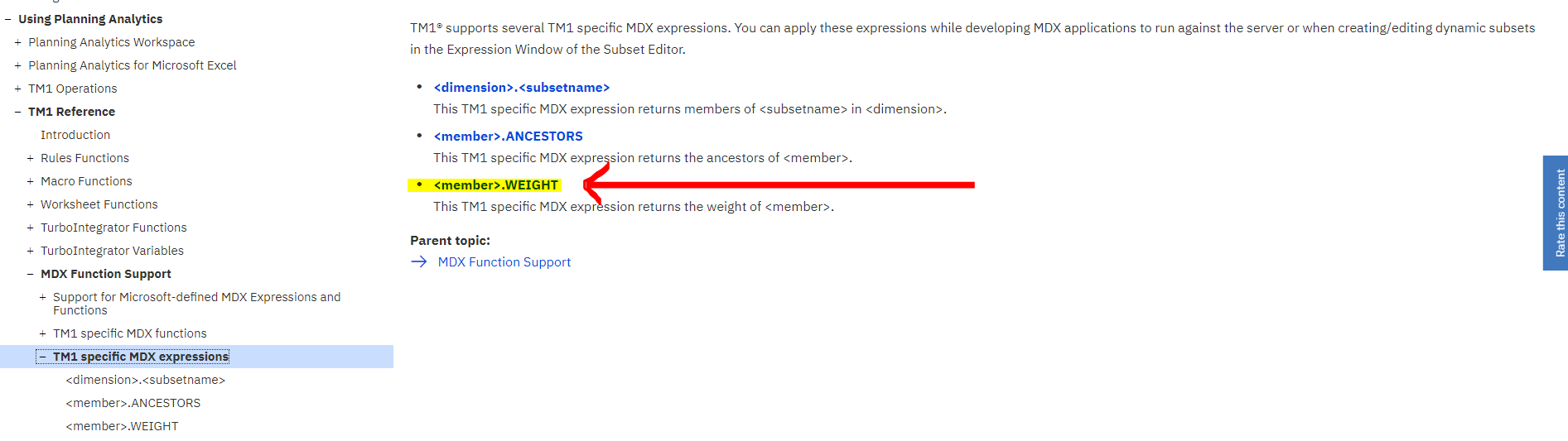

This one has made me curious:
Syntax
The weighting property controls how a child member rolls up to its immediate parent, whether that child is also a parent of another consolidation or just a leaf member. Top level consolidations do not have weight.
Please refer to this page
Can someone shed some light and provide an example ?
