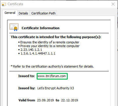

The certificate should be issued to the name of the server running TM1Web, so that it will contain "issued to: www.yourTM1.xxx" (like here, for "www.tm1forum.com" name). So yes, you need to provide the cert. request to CA
tm1forum SSL.png (13.99 KiB) Viewed 14648 times
