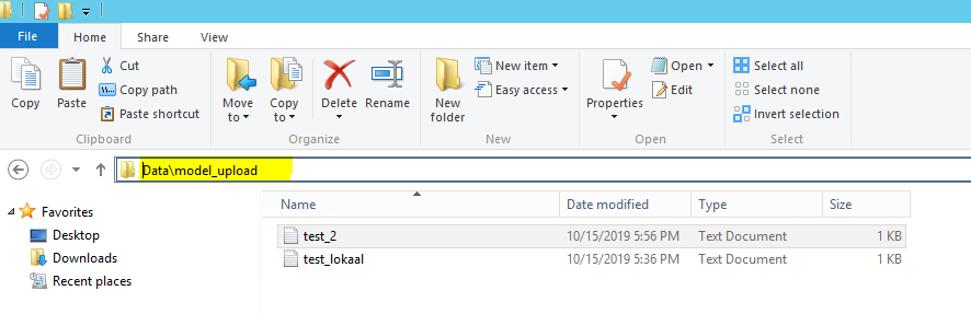

As it appears from my testing, you need to store/upload the file in the 'model_upload' folder, which is part of the TM1 data directory.
Actually, when you browse to a file, PA will upload a copy of the file and store it in that folder.
That file has no direct connection with your local/first file, so updating the first file will not let you see the details in the cube / dimension / subset / ...

I noticed this by opening the *.pro file for the process from the TM1 data directory (or opening up the process with Architect).

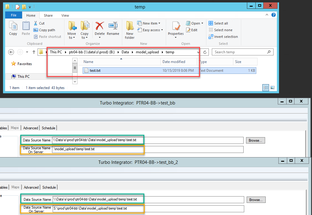

Let me answer my own question, I found it in IBM documentation by the way.
This works in Architect/Perspectives (PM not tested but probably as well):
PA paths.png (77.64 KiB) Viewed 9090 times
The screenshot is taken from a Partner platform on the cloud provided by IBM.
