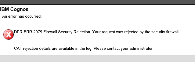

Interestingly I've managed to get it kind of working. Gtonkin I went through the link and added the pmhub file which was missing and set the parameters. It now does work as long as I don't use localhost on the machine itself. Also now when logging out I get the following error:
PA Web Firewall Error.PNG (10.72 KiB) Viewed 3371 times
