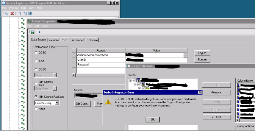

The user with which we connect in BI and packages to SAPBW, had to be changed. So in the BI data source connections, I updated the username and password. However, as of then, the package connector refuses to work. The error message is:
qe-def-0368 unable to decrypt username and password from the content store
In BI, the dumps still work. It's only the package connecter that refuses to work. Variables cannot be retrieved in the TI process.

Re: TM1 Package connector stopped working
Case solved through IBM technotes. Problem was the wrong Cognos Configuration instance was manipulated.
At the customer, there is a Cognos Configuration for BI, for TM1, for Framework Manager, and for the Package Connector.
We had the wrong one instances earlier.
