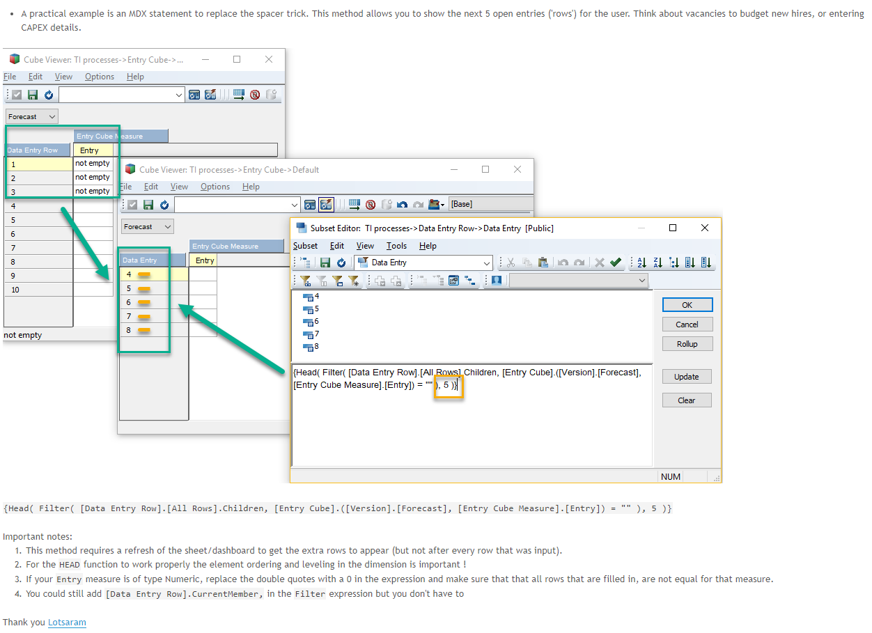

For MDX assuming you have a "data entry index" type dimension with placelolder measures named somethign like row1, row2, ...row99 then it is very easy to use MDX. All you need to do is use the HEAD function combined with a FILTER of the entry cube with the "data entry index" elements being empty. Usually I allow for 5 data entry rows at a time. not just one. Then if a user wants t do multiple data entry they don't need to refresh the page each time to get the next row. Just adjust the HEAD function to the number of rows you need and job done. (Note: for the HEAD fnction to work properly the element ordering and leveling in the dimension is important!)
E.g. something like
{Head(
   {Filter(
      {[Data Entry Row].[All Rows].Children},
      [Entry Cube].([Version].[Forecast],[Data Entry Row].CurrentMember,[Entry Cube Measure].[Entry]) = ""

@lotsaram: Thank you for the code example, it works great! I had the wrong approach - I tried to solve it with Tail, Lead, NextMember functions. I could identify the last element with data using filter and the tail function. Then I tried to use Lead or NextMember and that is where I got stuck.

I added this information to my MDX page
