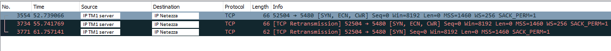

Not sure if this gives some information, but I can try: I attached a screenshot of Wireshark during one of the occurances (Wireshark filtered on Source or Destination equals IP TM1 Server). As you can see there is only traffic in one way and it immediatly stops (while a succesfull ODBC connection will result in many more lines).

The Netezza can handle quite some simultaneous load and we also experience it when the Netezza is idle. Also, the fact that WireShark does not show any traffic in the opposite direction makes me think the issue has to be located somewhere earlier.Steve Rowe wrote: ↑Thu Jul 18, 2019 8:04 am Hi, In my experience this usually happens because the destination server is locked performing some kind of major activity.

Based on your WireShark capture this looks to be a networking or Netezza issue.
You might try setting up pings to different hops on the route to Netezza to check.
