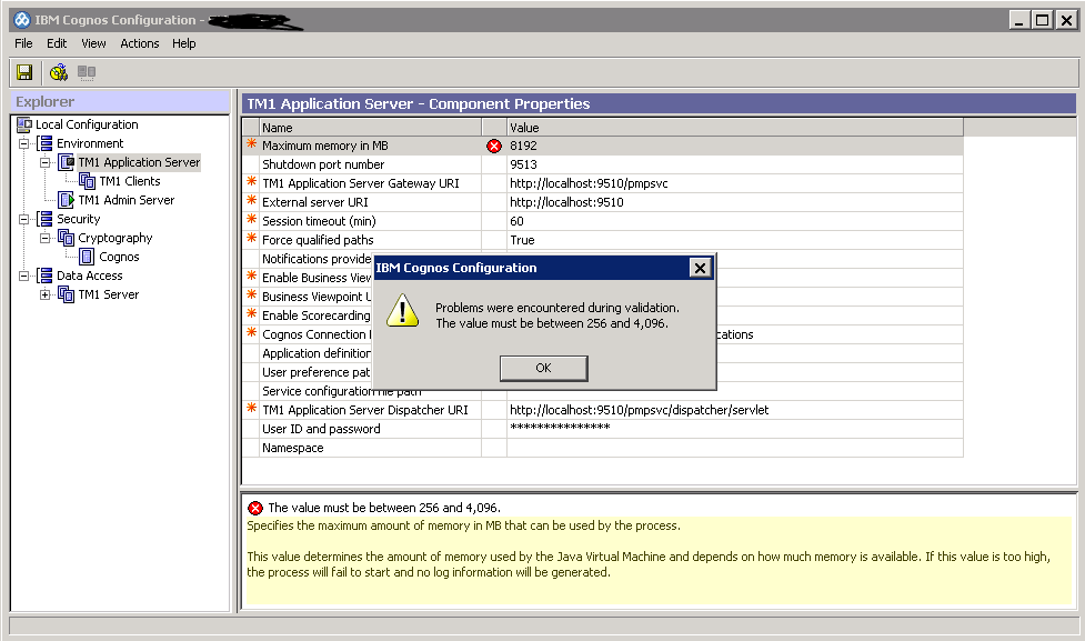

Option 1 didn't work. I stopped the "TM1 Application Server" as suggested and tried again, but as you can see from the image, without success.Option 2 I don't believe will work as we do not have PAW/PAX so are just using "old school" TM1 10.2
- JVM.PNG (30.63 KiB) Viewed 5604 times

Re: Unable to change JVM setting on TM1Web
are you certain that both TM1 environments are version 10.2. I only ask because I think in 10.1 the maximum it could be set to was 4096, and only in version 10.2 could it be set above this?
regards, Mark
regards, Mark
Hi Mark
Yes I think so. The build number of the model where I can increase the JVM is "10.2.00102.40547" and the number for the model where I am having these issues is "10.2.00000.36339".
Cheers
Ajay
