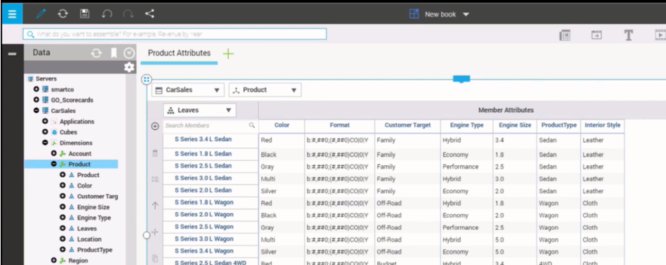

I have a requirement where I have to replace columns with element attributes. While trying to create, I googled and looks like it's possible from a screen shot from one of the IBM videos and I have attached. I have tried all possible ways and failed on version 30. Can someone please let me know the steps?

The screenshot you attached looks like it is from the dimension administration (in which case it will work fine on a sheet in a book but only for administrators and not end users).
In Perspectives you could just create a view of the }ElementAttributes cube but in Workspace control objects aren't accessible (based on last offering management AMA this might be coming but it will be a while away). As a workaround you could create a websheet with attribute names as columns.

In the picture I have attached, I was thinking they are not from attribute dimension. When we can drill using attribute hierarchies, cant we show them as columns not nested?
