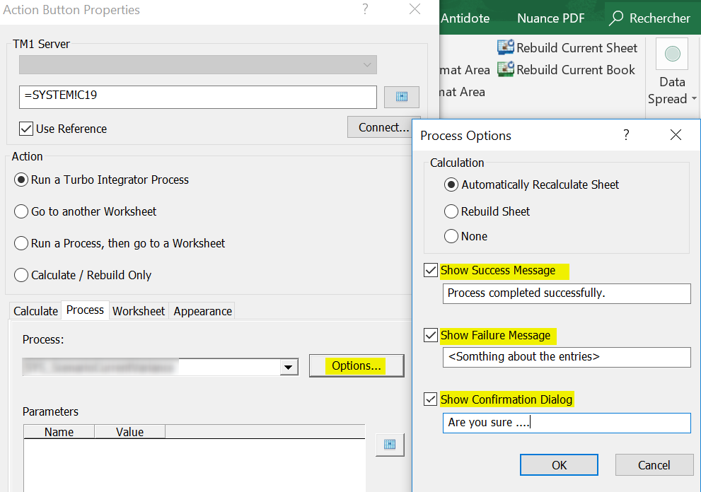

** I just realize my answer makes no sense to your question, however maybe it will help someone else **
I don't think there's an easy way to do that. However, here's my suggestion:
In your Excel form, create a formula to validate if all the entries are valid (0 = No, 1 = Yes). Also, a conditional formatting (0 = red, 1 = green) can be a good way to easily show that not all the entries are valid.
In your TI, add a parameter (i.e., pValidation) and add the following code at the top of the prolog tab :
You can also play with the Process Option to display messages.
IF( pValidation <> 1);
ProcessQuit;
ENDIF;- Attachments
