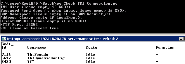

I have installed the tm1py libary.
While trying to connect (even through the sample connection) i get no response from the service and all gets freeze.
Attached the what I get in the TM1top.
I hope that someone can help me with this
Roei

Looks like you are using SSO. I was having the same issue with SSO, only by entering my credentials (LDAP credentials) I was able to get it to work.
When trying to connect with SSO, I was getting Status Code: 401 Reason: Unauthorized. We are using mode 2.
Give it a go and see if it works with explicit SSO credentials... maybe someone else here can contribute more to this?

Hi roei61,
It would help if you could add more information such as TM1 version (TM1py supports 10.2 FP5 as minimum), TM1 security, TM1py and Python version.
If TM1py can't connect, check.py should generate an error, so I'm not sure why it froze.
According to your screenshot, the Client CAMURI is empty. If you want to connect using SSO you will need to add the Client CAMURI which looks like this http://localhost:80/ibmcognos/cgi-bin/cognos.cgi
If you still can't connect, you should check if the TM1 REST API is enabled, more information here: https://code.cubewise.com/blog/enabling ... 1-rest-api
I hope this help
Cheers,
ByronB

Re: tm1py not connecting
Thanks that's may be the reason.
I'm using 10.2 FP2, hopefully after upgrading to PA it will work
Roei
Roei
