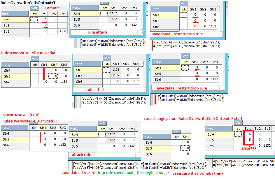

I have read the documentation and I understand its name as shown in the picture below.
Another question that I found an interesting feature is that it is marked with the third option. I suppose this is updated with the update of the cube and in combat situations it will lead you according to the documentation.

Drg wrote: Fri May 17, 2019 10:17 am I have read the documentation and I understand its name as shown in the picture below.
Appreciated your testing! I found my root cause now. It is because of PersistentFeeders. I have that enabled and obviously, after disabling, RulsOverwriteCellsOnLoad works as expected. :D
I noticed your third testing. Yes, it did happen to me as well and I have done further testing on that. Once they are zeros before rebooting with RulsOverwriteCellsOnLoad=F, if you write some new values to same cells, these old rule-overwritten values won't come back after rebooting. Seems that they have been deleted permanently. I am guessing IBM is using some "roll-back" mechanism to cache these old values somewhere for rolling back. Anyway, it is good to know. :lol:
