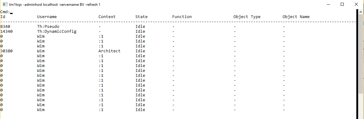

I run a simple TI process that copies data a number of times:
i = 1;
While( i <= 10 );
   RunProcess( 'CopyData_HoursSpent', 'pSourceMonth', '1', 'pSourceYear', '2019', 'pTargetMonth', '2', 'pTargetYear', '2019', 'pPerson', 'Wim' );
   i = i + 1;
End;
Yes, this means running 10 times the same process.
With ExecuteProcess I see that 1 thread is used in TM1top.
With RunProcess I see multiple threads. That's fine but after the process finishes the threads are still visible in TM1Top.
Shouldn't these threads be killed properly at the end of the process ?
I am logged in as admin and I start the process using admin.

Nah, these threads stick around in the exact same way as any other REST API threads do (because RunProcess uses REST API calls behind the scenes). Ultimately these threads do go away, perhaps when IdleConnectionTimeOutSeconds is reached (this needs to be confirmed). Not sure if this is really a problem beyond the visual clutter - the resource use of each thread is minimal.

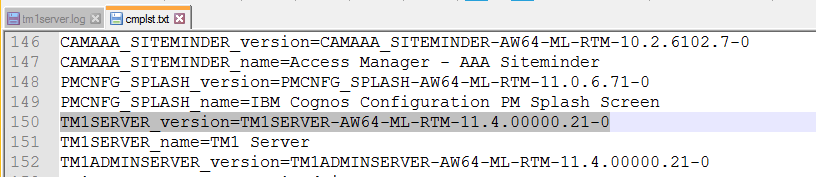

I can use it in 2.0.6. on my laptop. It's 11.4 (tm1s.exe = 11.4.0.21)
2.0.7 should be out either today, either early next week - so I have been told by someone from IBM.
