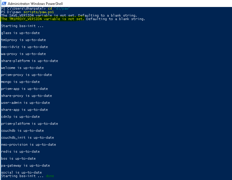

dharav9
- Posts: 72
- Joined: Wed Aug 15, 2018 3:18 pm
- Version: 10.3
Re: Error launching PAW 2.0.6
I am also able to see the same error. May i know what it stands for?
I did scripts/paw.ps1 stop & followed by scripts/paw.ps1. No luck.
Gateway and everything else getting created but TM1Proxy_Version and Save_version variable is not set message comes.
See the attached for further information.
Thank You
Dharav
Thank You
Dharav
- TM1 PAWPS1.PNG (15.4 KiB) Viewed 13687 times
dr.nybble
- Posts: 160
- Excel Version: Excel 2007
You can just ignore those, the docker-compose application will print that message out if an environment variable is referenced in a docker-compose.yml file but it is not defined.

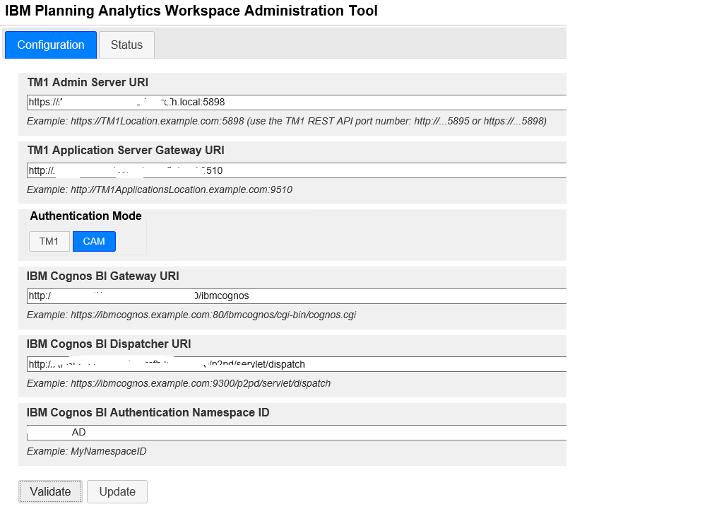

Paul-TM1
- Posts: 158
Hi Dharav,
Is your TM1 server running on "Security Mode =5"? Once this is done, it's all in the Configuration of PAW Admin Tool page.
I have attached a sample of how it should look.
Paul.
Paul.
- PAW-AdminToolPage-Config.png (35.89 KiB) Viewed 13647 times
