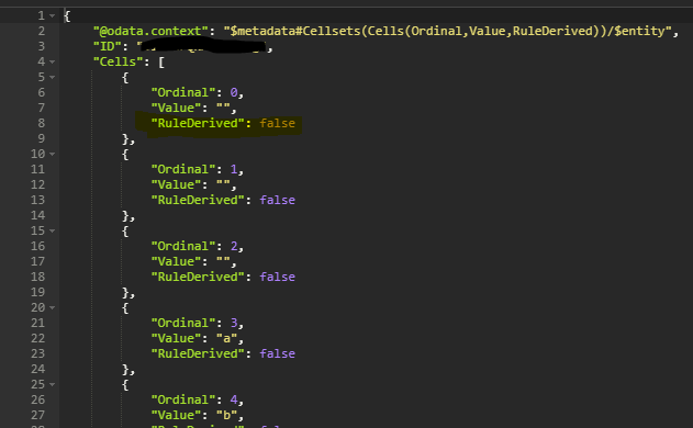

Hi @macsir,
I have a quick clarification on RuleDerived, I have made MDX request on REST api first then with the help of the ID I have made another request for
http://host:8000/api/v1/Cellsets('ID')?$expand=Cells($select=Ordinal,Value,RuleDerived)
This above returns all RuleDerived as "True", though rule are not specified in some cells.
Then I tried with
http://host:8000/api/v1/Cellsets('ID')?$expand=Cells($select=Ordinal,Value,RuleDerived,Updateable)
then it returns the proper value.. why the first request returning the values wrongly? and Idea?

I have tried in ARC for the rest api
First request:
Second request:
http://host:8000/api/v1/Cellsets('-first request cellset ID')?$expand=Cells($select=Ordinal,Value,RuleDerived)
return response "Rulederived" all as true. When I give "Updateable" then response is correct in all the versions.
Is there something wrong am doing here? which version are you using?

Re: Tm1 - mdx query for cube cellset
Posted: Fri Apr 12, 2019 8:15 am
by kavitha2002
I dont want the entire cube cellset, based on the query I would like to filter the cellset.
Herewith I have attached the screenshots for both the query.
Do have another question, Is there a possibility of saying which cell is editable, non-editable and type of the cell(String, Number, Consolidated).
Posted: Mon Apr 15, 2019 1:17 am
by macsir
Hi, I still couldn't see your original problem from your snapshots?

I have attached two text file of the same query, but one with Updateable and other not. In mdx_withoutUpdateable.txt, you can find the response "RuleDerived": false' for all the cells. But in mdx_withUpdateable.txt, response is correct and expected one.
For editable or non-editable, with false in "RuleDerived" and "Consolidated" properties, the cell is editable.
I tried the same, now am in good shape that to decide whether cell is editable or not.
Yes, I know in dimension level we can get the type of the element, but i need it on cells level:(
Posted: Mon Apr 15, 2019 9:11 pm
by macsir
Can't figure out why and couldn't reproduce your errors. I always got consistent results regardless of using updateable or not.
It might be a bug in some versions. Have you contacted IBM about this?
