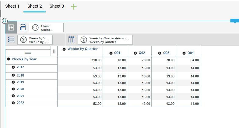

Next, an AH called 'Quarter' with a Total and consolidated children: Q01, Q02, Q03, Q04 (or leave out the 0). These consolidated elements contain the relevant weekly elements. Here it will probably depend on 444 or 445 so this might lead to 2 separate AH. Make sure weeks are level 0 below the quarters in this AH.
Likewise, an AH called 'Month' with a Total and consolidated children: M01, M02, M03, ..., M12. These consolidated elements contain the relevant weekly elements. Here it will also probably depend on 444 or 445 so this might lead to 2 separate AH. Make sure weeks are level 0 below the months in this AH. You might want to add a week below 2 different month consolidations with a weight different from 1. It will be important to know / determine how a week falls within a/each month. Put differently, you need to maintain a calendar in a different cube. In the past I have solutions like input of the percentage of each week in each month. 2 days out of 5 would be 0.4 as the weight of week X in month Y. These weights will need to be used in setting up the hierarchies.
Yearly view in an AH: 'Weeks by Year'. Elements: Weeks by Year > 2018, 2019, 2020, 2021, ... > yyyy_W01, yyyy_W02, yyyy_W03, ..., yyyy_W52/53. This is very easy in theory. Yet in practice: could it be that some weeks are spread over 2 contiguous years ? Then same reasoning as for months.

In the screenshot you can see a mock-up: a value of 1 for 'Client 01' in any of the weeks.
