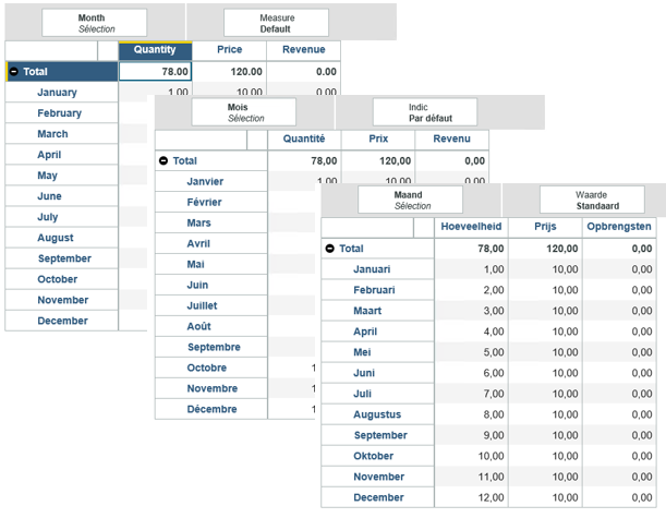

We can for instance have this result in PAW:
whereby I localize using a TI process:
- visible in the screenshots: element names, dimension names

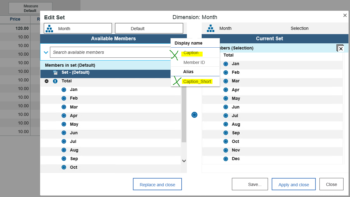

You will understand the one issue here. The users can switch aliases:
I would like to localize the 2 alias names too since someone who does not understand English (which is rare but still) will not want to see Caption and Caption_Short. Yes, we can train the users, and yes we can be consistent in our naming of aliases over the different dimensions/hierarchies but still I prefer to see:
- "Long name" and "Short name" if language = English
- "Nom long" and "Nom court" if language = French
- "Lange naam and "Korte naam" if language = Dutch

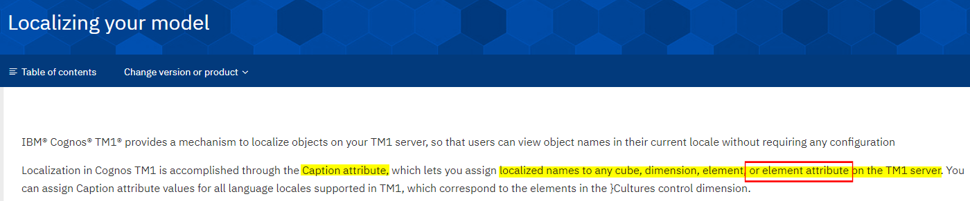

- can we localize attribute names ? According to the documentation yes: https://www.ibm.com/support/knowledgece ... model.html
- in general, can we have in TM1 attributes on attributes ? (Control objects on control objects)

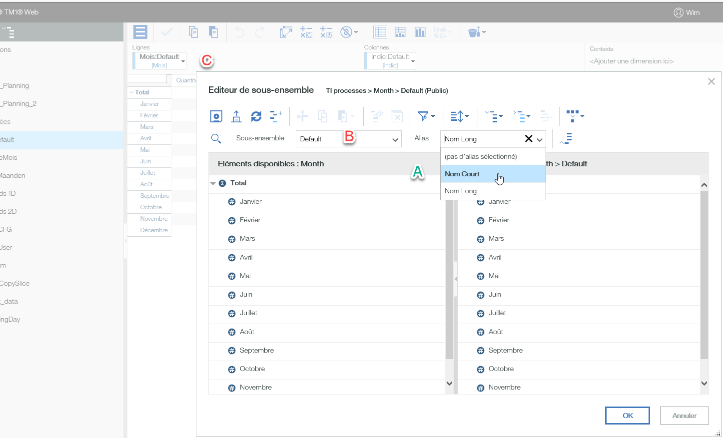

Good news, it works in TM1 Web on my local machine, 2.0.6. See A in green.
I have no PAW installed on my machine.
On the remote machine where I used PAW I cannot be certain about the TM1 server version but I think it's 2.0.4.

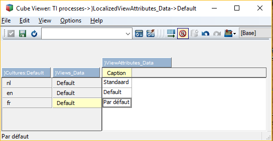

What does not seem to work in TM1 Web 2.0.6 is the localized view and subset names. See B and C it should be 'Par défaut' instead of 'Default'. I don't understand why since the functionality works in PAW (2.0.4 I think) but on that server with PAW 2.0.4 TM1 Web does not work so I cannot test it there.
