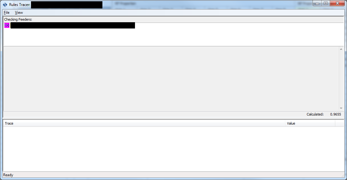

by jamesbennett
Definitely check feeders! See the picture if it works:
Re: Cube Viewer suppress zeroes hiding non-zero cells
Posted: Sun Jan 27, 2019 10:39 am
by David Usherwood
That does look correct - but I am pretty sure you do have a feeder issue. Suggest you restart the server and recheck - possibly you have conditional feeders and the parameters have changed without a restart or refeed.
