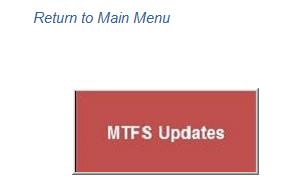

Watch the start of this video (https://www.youtube.com/watch?v=pxjnKz9-h7M) for the general idea of putting the button below the image (though in this case they use hyperlinks but it can easily be done with action buttons). If your button no longer works try deleting and recreating it
For option 2 (see image below), if you use a normal image you are going to struggle to get rid of the border affect, at least that is my experience. We moved away from images with pictures toward images with wording, as you can see from the image. I admit the image still isn't perfect by any stretch but I think it does look cleaner than a picture and getting a picture to size correctly is a headache I can do without!
I created the image in excel via a textbox with a black outline, copied the textbox into word and saved it as a jpeg. After trial and error I determined the jpeg should be 182 x 87 pixels (but in order to get this sizing in the jpeg I had to get the sizing correct in word). Basically it involves trial and error, at least it did for me!
The other alternative is that you live with the border!
cheers, Mark
