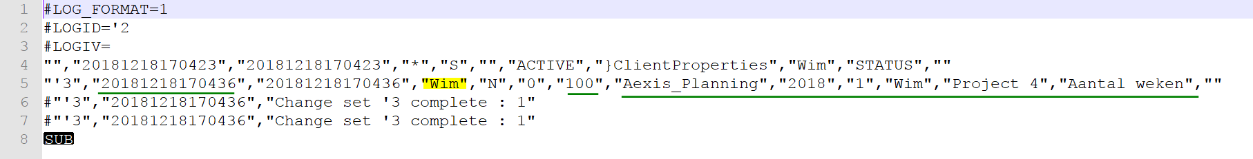

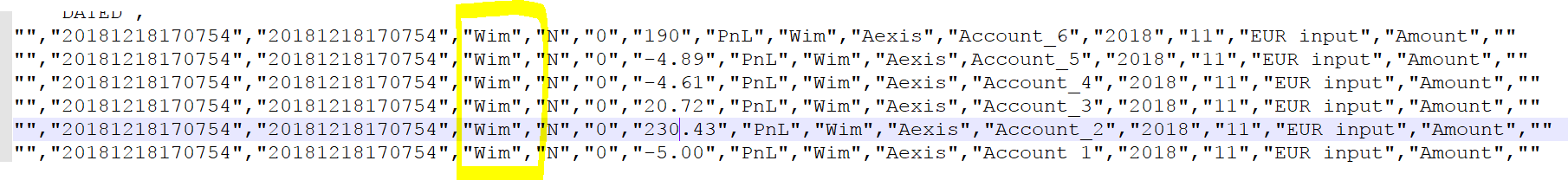

As to the question, I don't understand what you mean. In the transaction logs, I do see the user name that initiated the change. For manual entry (in yellow the username):
If it's done via TI:
Wim
Welcome to the forum. Can you please post questions in the correct subforum ?
Wim
