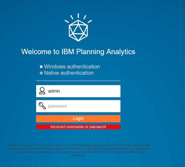

Re: Tm1 mode 2 or 3 with SSO
Working with mode 2 in TM1 pax, if my understanding is right, I have chosen the Native authentication, and gave the "admin" and password which is TM1 credentials but it not working. -- error incorrect username and passwordThe difference between 2 and 3 is that 2 allows EITHER AD authentication OR native TM1 security, based on the client's choice, while 3 only accepts AD authentication.
chosen the windows authentication, gave AD credentials that was working. I didnt configure the IntegratedSecurityMode3 yet.
