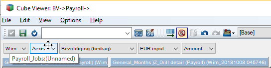

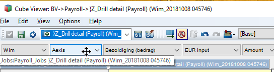

To make the example more visible, here I added 3 screenshots:
1: the view selection dropdown is empty and the drill view is not selected. Moreover, the 2 row dimensions contain the correct subset (with name and timestamp in it), but the subsets in the titles do not show the subsets I created (with the same variable name).
2: to be clear, the drill view is created
3: here I selected the drill view. All subsets contain the correct variable name.

Hi Wim,
This bug seems to have been there for a while. IMO it's harmless as it is just a display issue. As long as the user is directed to the correct target view layout with the correct element son filter and subsets on rows & columns that's what really matters.
