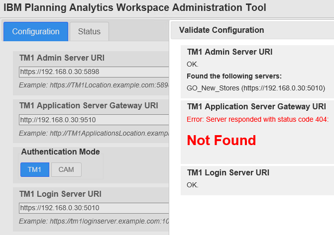

I have a Win 2016 server running under Hyper-V. I moved the disk image from one host to another which also required new Network Adapters as the virtual switches are different. There are 2 adapters currently bound but only one will ever be active.
PAW was working just fine but now after starting the Admin tool to change the IP addresses, I cannot validate the Application Server Gateway:
My ethernet address is: 192.168.0.30 and the HNS is 172.30.80.1
I can login in to TM1Web, TM1, PAX etc. (Obviously cannot access the editor to change elements/members)
I cannot connect to PAW as it is probably not configured correctly yet.
All PAW processes other than Initialization say Running, Initialization says Completed.
I have tried the following so far:
-Numerous restarts and curses
-Changed the Interface Indexes for the new adapters to be lower than those of the HNS adapter
-Ran NETSTAT -a to see what ports are listening (listing what I think is relevant):
172.30.80.1 ->53, 139
0.0.0.0 -> 5010, 5498, 5895, 5898, 5985, 7999, 9510
I am not seeing anything listening on port 80 yet - expecting this for the PAW login/form
Any suggestions would be very welcome - thanks in advance.
BR, George.

404 means you are talking to the application server, but the /pmhub/pm URL is returning 404.
Make sure PMHub is running. Or if you don't care about PMHub you can ignore it.
You also do not see anything bound to port 80 through the Docker NAT networking with netstat.
Try running scripts/launch.ps1 to connect directly to the PA Gateway container.

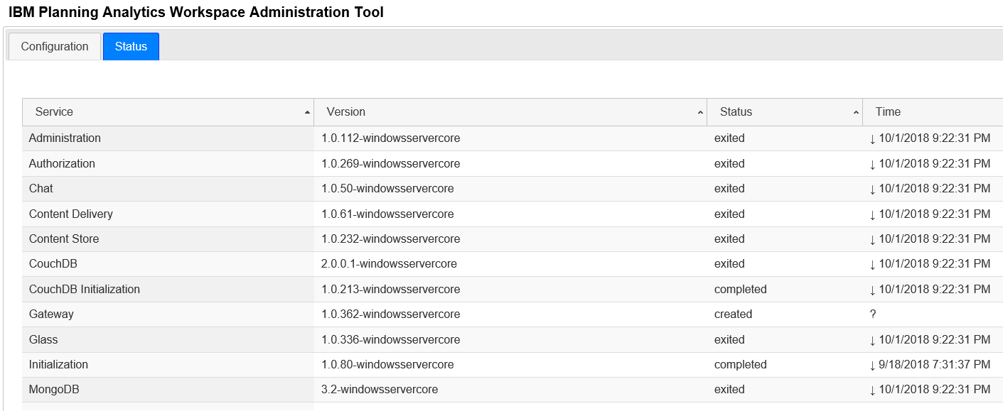

Hi Dr Nybble, think we are getting closer.
After executing paw.ps1 and starting the Admin tool, I am able to validate and update again.
When checking services however, Gateway shows as Exited, no logs found for Gateway (and in the PA-Gateway folder)
Restarting the server causing the Admin tool to exit with an exception: Execution failed with exit code 1
I have tried rebooting after a successful update but starting the Admin tool and checking services always shows that the Gateway service has exited.
What can you recommend?
Thank you.
Edit: tried to start PA-Gateway manually via Docker start PA-Gateway and received:
Error response from daemon: failed to create endpoint pa-gateway on network nat: HNS failed with error : The object already exists.
Error: failed to start containers: pa-gateway
Edit 2: ran 'docker system prune' and restarted the admintool - may have broken the PA-Gateway as it just says Created and status is ? - starting it crashes the admintool with the error above.
BR, George.

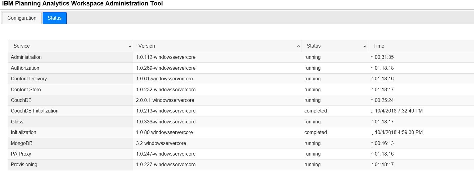

After re-installing, everything seems to be up and running except there is no Gateway service??????
Docker images does show the image is available.
Is there a way to manually create and trigger the Gateway service - it should happen automatically.

Something definitely not right with PAW on this machine - after all that, my windowsfilter folder is now 70Gb again and cannot start services as there is no space left on my device.
BR, George.

When running >docker ps, I am expecting to see PA_Gateway but do not see it. It somehow did not get added. I did try the upgrade/install option again when starting the Admin Tool but without success. All other services seem to eventually enter a running state, other than Initialization.
CONTAINER ID        IMAGE                                                                       COMMAND                   CREATED             STATUS              PORTS                    NAMES
5e482ca0cf7c        pa-docker:5000/planninganalytics/admintool:1.0.72-windowsservercore         "powershell -Comma..."    2 days ago          Up 2 days           0.0.0.0:8888->8888/tcp   admintool
5e4995e4afd8        pa-docker:5000/planninganalytics/wa-proxy:1.0.247-windowsservercore         "powershell -Comma..."    2 days ago          Up 2 days           1338/tcp                 wa-proxy
c2e915bda48f        pa-docker:5000/planninganalytics/share-platform:1.0.55-windowsservercore    "powershell -Comma..."    2 days ago          Up 2 days                                    share-platform
9bfb9bc7cdf5        pa-docker:5000/planninganalytics/welcome:1.0.185-windowsservercore          "powershell -Comma..."    2 days ago          Up 2 days                                    welcome
854e7db2ec82        pa-docker:5000/planninganalytics/prism-app:1.0.3022.2-windowsservercore     "powershell -c C:\\..."   2 days ago          Up 2 days                                    prism-app
9666319ce8f4        pa-docker:5000/planninganalytics/prism-platform:1.0.856-windowsservercore   "powershell -Comma..."    2 days ago          Up 2 days                                    prism-platform
14dc6ff2fec3        pa-docker:5000/planninganalytics/share-proxy:1.0.119-windowsservercore      "powershell -Comma..."    2 days ago          Up 2 days                                    share-proxy
16a342f3ed85        pa-docker:5000/planninganalytics/share-app:1.0.24-windowsservercore         "powershell -Comma..."    2 days ago          Up 2 days                                    share-app
d377f88f1077        pa-docker:5000/planninganalytics/redis:2.8.2402-windowsservercore           "powershell -Comma..."    2 days ago          Up 2 days           6379/tcp                 redis
88eefad393cf        pa-docker:5000/planninganalytics/mongo:3.2-windowsservercore                "mongod --smallfil..."    2 days ago          Up 2 days           27017/tcp                mongo
15435c156593        pa-docker:5000/planninganalytics/bss-init:1.0.80-windowsservercore          "powershell -Comma..."    2 days ago          Up 2 days                                    bss-init
fa1a3653f86f        pa-docker:5000/planninganalytics/couchdb:2.0.0.1-windowsservercore          "powershell -Comma..."    2 days ago          Up 2 days           5984/tcp                 couchdb
3ae9e16d30b6        pa-docker:5000/planninganalytics/couchdb_init:1.0.213-windowsservercore     "powershell -Comma..."    2 days ago          Up 2 days                                    couchdb_init
1ff9c9b6a58f        pa-docker:5000/planninganalytics/neo-idviz:1.0.232-windowsservercore        "powershell -Comma..."    2 days ago          Up 2 days           9060/tcp                 neo-idviz
d268a1532a21        pa-docker:5000/planninganalytics/bss:1.0.269-windowsservercore              "powershell -Comma..."    2 days ago          Up 2 days           8082/tcp                 bss
e02003c4c542        pa-docker:5000/planninganalytics/user-admin:1.0.112-windowsservercore       "powershell -Comma..."    2 days ago          Up 2 days           3333/tcp                 user-admin
168487d24fc2        pa-docker:5000/planninganalytics/cdn3p:1.0.61-windowsservercore             "powershell -Comma..."    4 days ago          Up 2 days                                    cdn3p
be707525a55f        pa-docker:5000/planninganalytics/prism-proxy:1.0.3819.1-windowsservercore   "powershell -Comma..."    4 days ago          Up 2 days                                    prism-proxy
5547572128ad        pa-docker:5000/planninganalytics/glass:1.0.336-windowsservercore            "powershell -Comma..."    4 days ago          Up 2 days                                    glass
6d32646f3fb5        pa-docker:5000/planninganalytics/neo-provision:1.0.227-windowsservercore    "powershell -Comma..."    4 days ago          Up 2 days           8083/tcp                 neo-provision
BR, George.

Run:
scripts/paw.ps1
You may see all containers (including stopped ones) with docker ps -a
The initialization container will exit when it has done its job.
