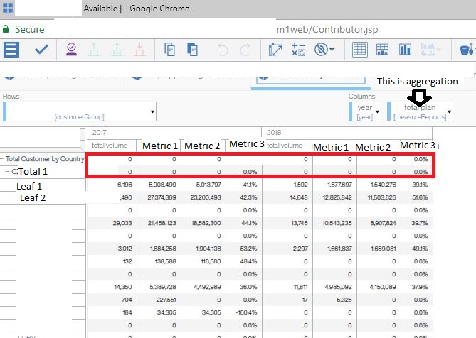

we came accross a interesting issue on TM1 Production environment after creating view for one particular cube. After these modelling changes all of the views of this cube do not aggregate consolidations on rows and columns, while in the context consolidations work fine.
This behaviour appears dynamically, so swapping dimensions results in not-working consolidations of the dimensions on rows and columns that are shown at the time.
This issue happens only in TM1 Architect and TM1 Contributor. In PAW, TM1 Web and Porformance Modeler everything works just fine.
After showing aggregations in any of the working clients, TM1 Architect and Contributor shows the consolidations only for those particular cells.
We have tried restarting Web server without any progress. The only thing that works is restarting the instance, but the issue appears again after cca 3 hours of no activity on the server...

- Not aggregating values.jpg (92.62 KiB) Viewed 7286 times

Hi, thanks for the suggestions - feeders are correct as in context there are consolidated elements. Weighting is set to 1 on all the elements. The stated behaviour is dynamic - when swapping dimensions from context to rows, consolidations do not work on that particular subset used in rows and columns...

"When I look at particular consolidations on rows and columns , they display as zeros. When I look at the same elements as context / page / header references I get the results I expect. I only see this in the Cube Viewer in Architect or TM1 Web(?)
Restarting clears the issue for a bit"
I don't recognise the term TM1 Contributor, I think you mean the cube viewer in TM1 Web, this seems to be what is in your screen shot.
If we assume this is not a bug I would be looking very hard at the rules for the cube, in particular C level rules and Consolidate Children functions both of which can make the results unusual...

Hi I managed to find out what caused the issue, even though I do not know why it caused it:
In tm1s.cfg there has been specified parameter ViewConsolidationOptimization=F (default =T), to optimize the performance when loading the views.
From official IBM documentation:
View consolidation optimization stores the consolidated values that use leaf element components on either the row or column axis. For example, consider the dimension structure Year, 1Quarter with values Jan, Feb, and Mar.
Although this parameter should be changing only optimization, it (when something goes wrong) stops the consolidation when openning the view...
Tomas
