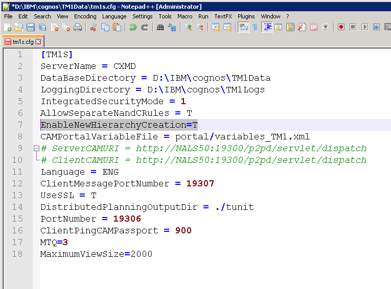

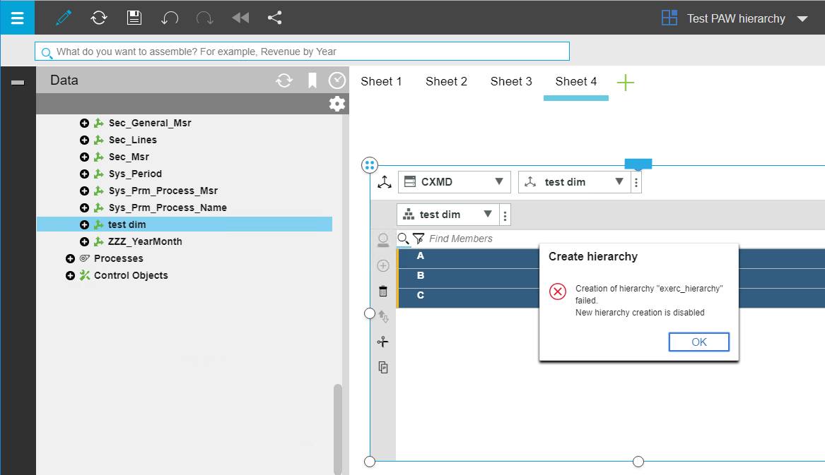

I am trying to use the new hierarchies functionality. However, it seems that this functionality has been disabled:
I added the new cfg entry and I restarted TM1:

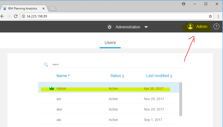

I am an Admin user in TM1 and PAW. The PAW version is 2.0.29, TM1 is also certainly recent enough:

As far as I can remember, the only thing that needed to be changed to do this in TI is the TM1S.CFG setting you have already identified.

In fact, I checked the manual approach of creating a hierarchy, since the TI approach did not work. Same error message.
I will now look at the users but the user I used is an Admin user in TM1.
Running the TI process in Perspectives with that Admin user gives the same error message in the message log, the fact that "New hierarchy creation is disabled".
In PAW I use the same user from TM1. It shows as Administrator:
I would assume this user is able to create a hierarchy ?

I logged on with the test user, I tried to create a hierarchy and I get the same message that hierarchy creation is not enabled.

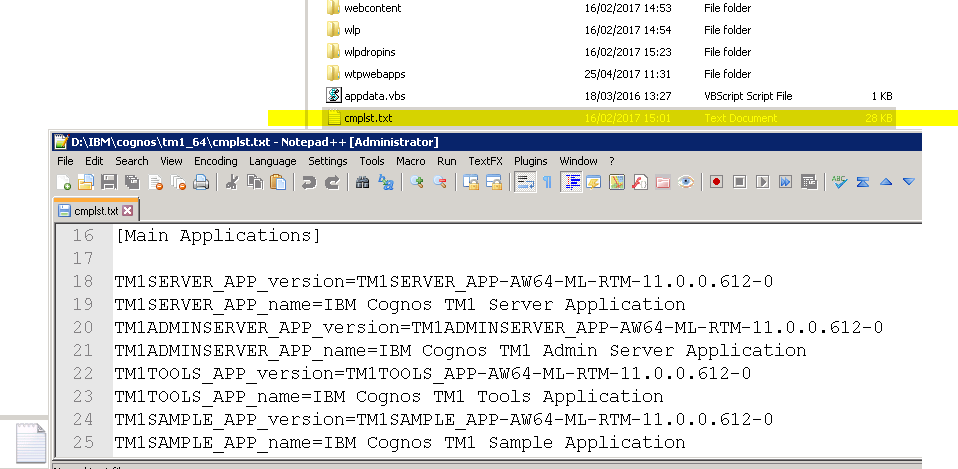

Case solved. I changed a CFG file in the TM1 data directory whereas the real CFG file was in a different folder. I should have checked that earlier.
