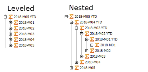

For sure the issue of massively more members than elements can apply to any dimension where elements have multiple parents but it is more likely to be a significant issue and potentially cause problems in day level time dimensions as there are likely to be far many more alternate rollup paths defined for reportign and calculation purposes than you would ever encounter in a business dimension.
In terms of Paul's question about building YTD with only single parent yes this is no problem if taking a nested approach.
In this example there are 2 approaches to building a "YTD by Month" hierarchy for a date level dimension. Either leveled or nested. Leveled has the advantage of being a bit easier to navigate and elements of the same reporting concept share the same level, but it will have multiple parents per element. On the other hand a nested structure will have only a single parent per element and therefore the same member count as element count. To preserve # members = # elements then rollups for organizational purposes need to be avoided.
If also considering a "YTD by Day" rollup then the issue becomes (much) more extreme in terms of the disparity between # members and # elements with each approach. And of course Dec 31 YTD is then 365 levels deep. My experience with this is that TM1 doesn't seem to have an issue with the ridiculously long full member names. It's still the absolute count of members that seems to cause memory blowout not anything else. For sure if you want to have BOTH a YTD by month AND a YTD by Day rollup then they need to be separated into distinct alternate hierarchies to avoid the day level elements having multiple parents.
