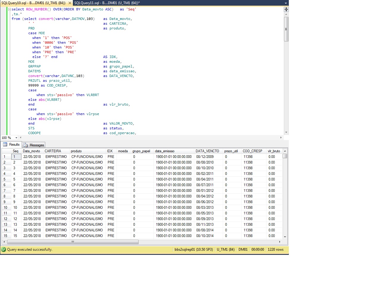

Hi guys,
I have a query that is running (attached) on sql server and after a copy and paste on tm1 turbo integrator it doesn't work! It's crazy and I don't know what to do anymore.
The message on log is "[SQL Server]Unclosed quotation mark after the character string ' '. " I've checked many times and there is not wrong.
------------------- Query -------------------------------

Please help me!

It might be due to the question mark (?) in the query. TM1 could be thinking you are trying to insert a parameter.

It is that!
AMAZING tomok.
You saved me.
Thanks a lot man!!!
tomok wrote: ↑Tue May 22, 2018 2:14 pm It might be due to the question mark (?) in the query. TM1 could be thinking you are trying to insert a parameter.
