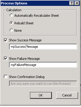

Hi all
Noticed a change in when a success/failure message is shown, before or after the sheet is rebuilt. In 10.2.2 the message is shown after the sheet is rebuilt, in PA 2.0 (11.1.0.30) it's shown before.
Have you run into this, is it a bug/new feature?

Yes, I'm running the two versions in parallel on two servers, and it's a clear difference. This is an issue in my case as I want to display a dynamic success message. My process reads data from a DW, and I store # read transactions in a log cube. A DBRW will retrieve this information, which will then be included in the success message. E.g. 'Number of transactions read: 123456'. Now, if the message is displayed before the sheet is rebuilt/recalculated, the success message will show transactions read from the previous execution. I have to run the same process twice to show the correct success message.
I have also noticed this with confirmation dialog. I click No, I don't want to run the process, but the sheet is still rebuilt after that I click No.
