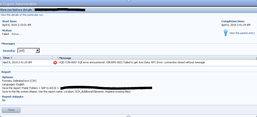

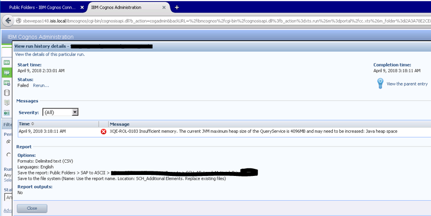

At a major TM1 site where I spend a good deal of my time, they have SAP ECC, SAP BW and this is coming to TM1 through the use of both:
1. Cognos BI (which dumps data extracts from SAP BW queries overnight into text files)
2. the TM1 Package Connector, straight to SAP BW.
Both metadata and data will be transferred to TM1.
In the past, only option 2 was chosen, but the night window was too short to handle it all. Since end of last year, users can still launch TI processes with option 2, and at night we schedule jobs in BI to do the exports.

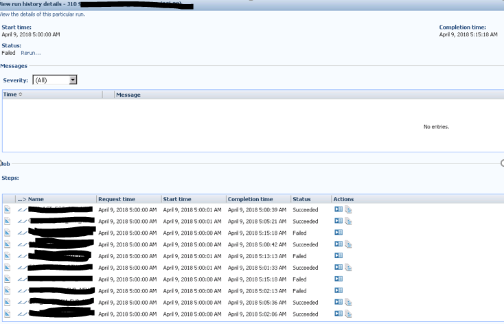

This more or less works but nevertheless we get a number of strange errors. Sometimes in a night all of the jobs (about 20-30 jobs) fail, the night after all are fine, and yet another night some jobs fail and some succeed.
It is for example:
- the connection from BI to SAP BW cannot be established, while the network shows no problems whatsoever
- memory issues

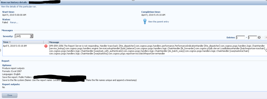

- the errors below.

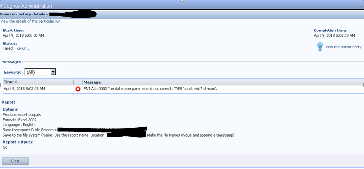

And 2 more screenshots:
and
