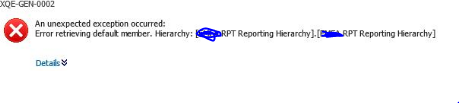

HI Reuben,
Is it efreshMdxHierarchy(''); function working for you ?
Today i also faced same issue i am getting error like attached screen shot , Could you please reply .
