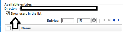

Here you go, don't you have this option in your AD?
And there is another way, go to you AD and click on search link at the upper right corner, you can find individual user as well.
