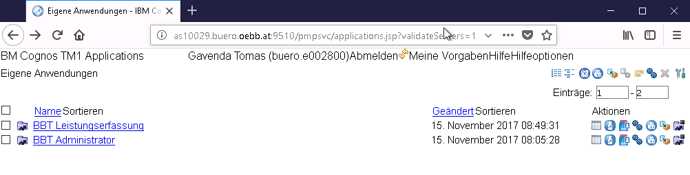

Hello all,
we have installed IBM Cognos Planning ( 2.0.3 ) Applications. If i call the pmpsvc everything works fine. Only that there is no style formatting inside,
I hope that someone can help me to find what it is worng with my install
see Schrren
screen TM1 applications.png (20.38 KiB) Viewed 4350 times
thx Chris

Does the same issue occur in alternative browsers? Are you using a supported browser from the software compatibility report?
IBM Software Compatibility Report
For PA 2.0.3 Local, Internet Explorer 11 is the prerequisite minimum required although you could expect some/ most of the functionality to work in prior versions

found the Solution. Reason was an old Custom Style we used comming from modified Version 10 Installation (doesnt work in v11 anymore).
