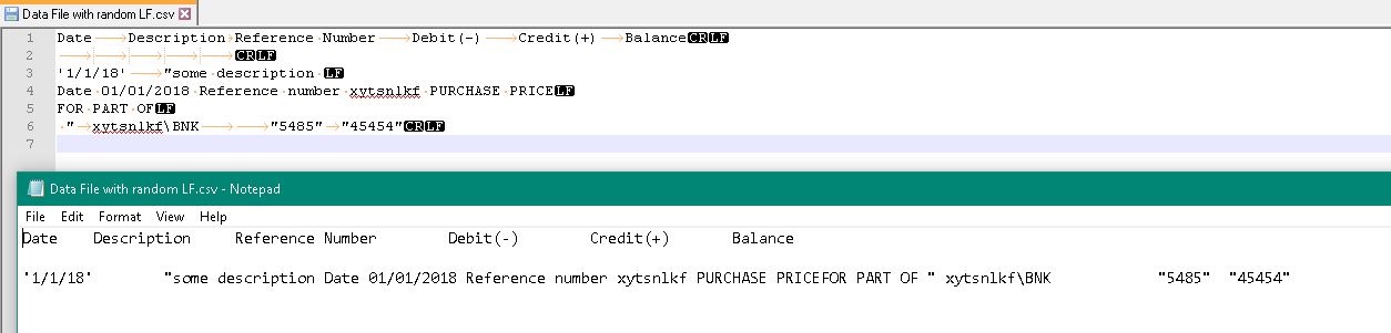

Try this:
powershell.exe -Command "(Get-Content -Path 'C:\Temp\Data File with random LF.csv' -Raw) -replace '([^\r])\n', '' | Set-Content -Path 'C:\Temp\Data File without random LF.csv'"
And Perl has some problems with LF on Windows:
The ultimate guide to Windows and Unix file line ending conversion in Perl https://www.perl.com/article/53/2013/12 ... n-in-Perl/
