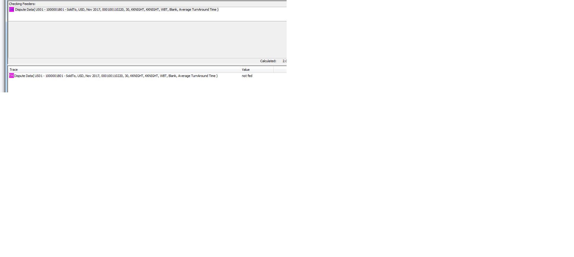

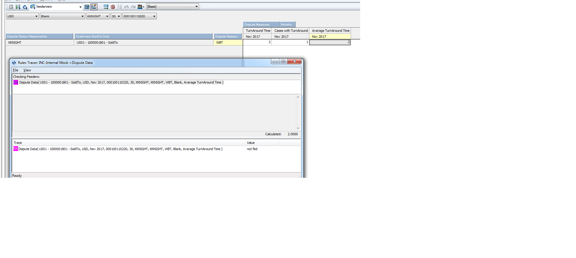

Now I have attached the results saying not fed , but when I click on check feeders at lowest level
Its showing up
the calculation taking the value of DB('Dispute', All dimension , 'AverageTurnArounTime');
It should take the turnaroundtime/caseswith turnaround right?
Attached both the check feeder and cube data screenshot .

i would say the feeder "['TurnAround Time'] =>['Average TurnAround Time' ] ;" looks good.
What do you see, wenn you "Trace Feeder" from the elment "TurnAround Time".
What happens when you restart the database?
Another idea:
"Average TurnAround Time" as a consolidated element with childs "TurnAround Time" and "Cases with TurnAround". then you do not need the feeders because the hierarchy feeders itself.
Another idea:
