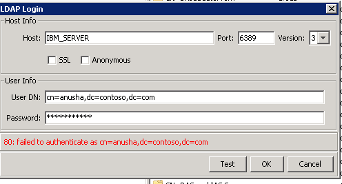

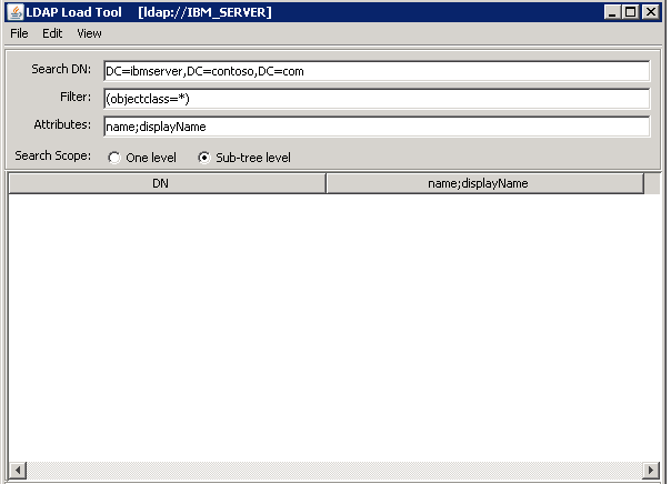

I am trying to integrate TM1 with Active Directory. I am struggling errors in ETLDAP, matching entries are not found and failed to authenticate LDAP login.
Please share your experience and document if any.

Are you looking to hook directly into active directory or to utilise LDAP?
There are many guides online for setting up security in TM1 and this is a useful starting point:
http://www-01.ibm.com/support/docview.w ... wg21456988
Looking at your existing configuration is your AD/ LDAP server called IBM SERVER?
