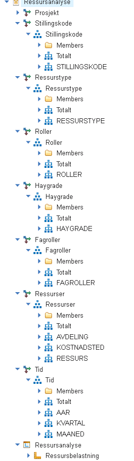

I'm a noob at creating reports with TM1 cubes as source (10.2.2 FP7), so guidance would be appreciated. I have a couple of years of experience of using Cognos framework packages and dynamic cubes, so i'm quite experienced at making reports with MDX -A colleague has made a summary cube, which I use as the source:
The report is a crosstab with a promptpage.
The prompts are made based on promptmacros put in the slicer:
#promptmany('pStillingskode','memberuniquename','
[Ressursanalyse].[Stillingskode].[Stillingskode].[Totalt]->:[TM].[Stillingskode].[Stillingskode].[@MEMBER].[Totalt Stillingskode]','set(','
[Ressursanalyse].[Stillingskode].[Stillingskode].[STILLINGSKODE]',')')#
The issue i'm experiencing is that the report takes around a second to run when I run it without the summary rows, but when I add summary rows it takes 2-3 minutes, with the exact same selection.
Do you guys have any advice?
edit: I have the same issues in Cognos 10.2.2 and CA 11.0.6
