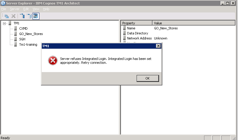

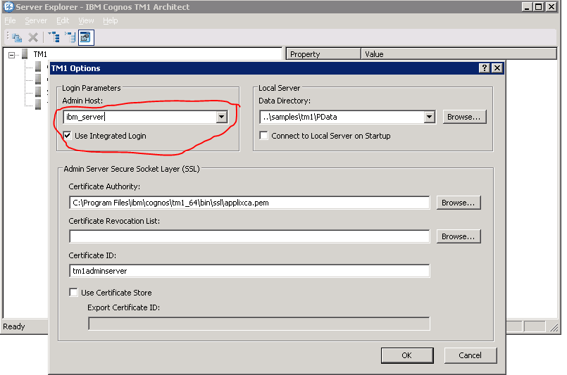

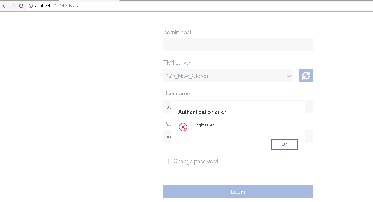

I am trying to create active directory users in planning analytics.I have updated the tm1s.cfg file with the IntegratedSecurityMode=5 and added active directory users in TM1 configuration file. But unable to login with active directory users.Do I need to make any other configuration please advice

http://www-01.ibm.com/support/docview.w ... wg22000283
Many steps to follow but this is the only way now for all PA components.
Alternatively you can wait for the next update from IBM which promise a mode 3 with PAW.

i guess this is the right document:
https://www.ibm.com/support/knowledgece ... _cont.html
the other is describe the Settings using SSO. This is not needed if you want to use AD only ( write the credantials during login )
Chris
