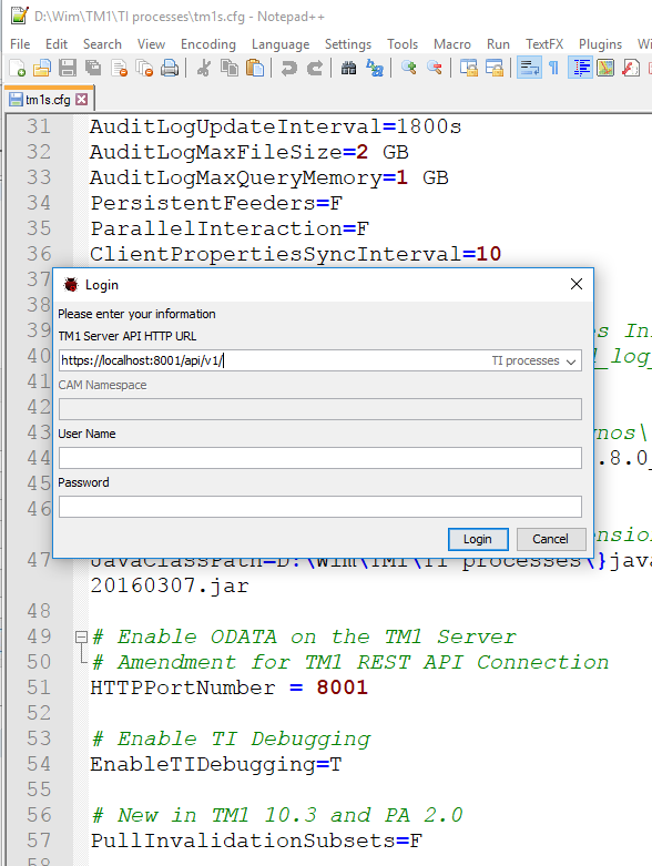

Are you sure the port number is correct ?
You added EnableTIdebugging=T ?
For me it works fine with:

Thanks Wim,
You are right, the port number is 12354, I had it as 12345. Very silly mistake!
