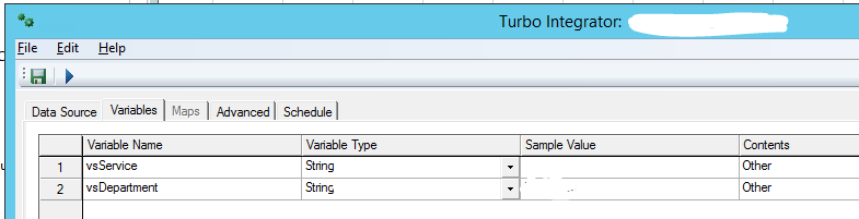

If I understand your post correctly, you want to load data from a CSV file with two columns which are "Service" & "Department".
To do this you need to set the CSV file as your data source, then look at the variables tab to configure your CSV columns not paramaters.
In the image below the two variables will present once for each row from the CSV in the Metadata & data tabs which is where you make dimensional changes and put data in your cube.
Parameters can be used to load data but generally where a specific piece of data is passed from a user interface or another TI process.
