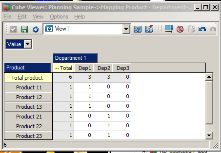

1. I have a mapping cube with dimensions: Department1, Product, Measures, where I can set NxN mapping for departments and products.
I can use this mapping for creating a dynamic subset in Product dimension in any cube view with Department1 in context and Product in rows (cube1):
This works fine

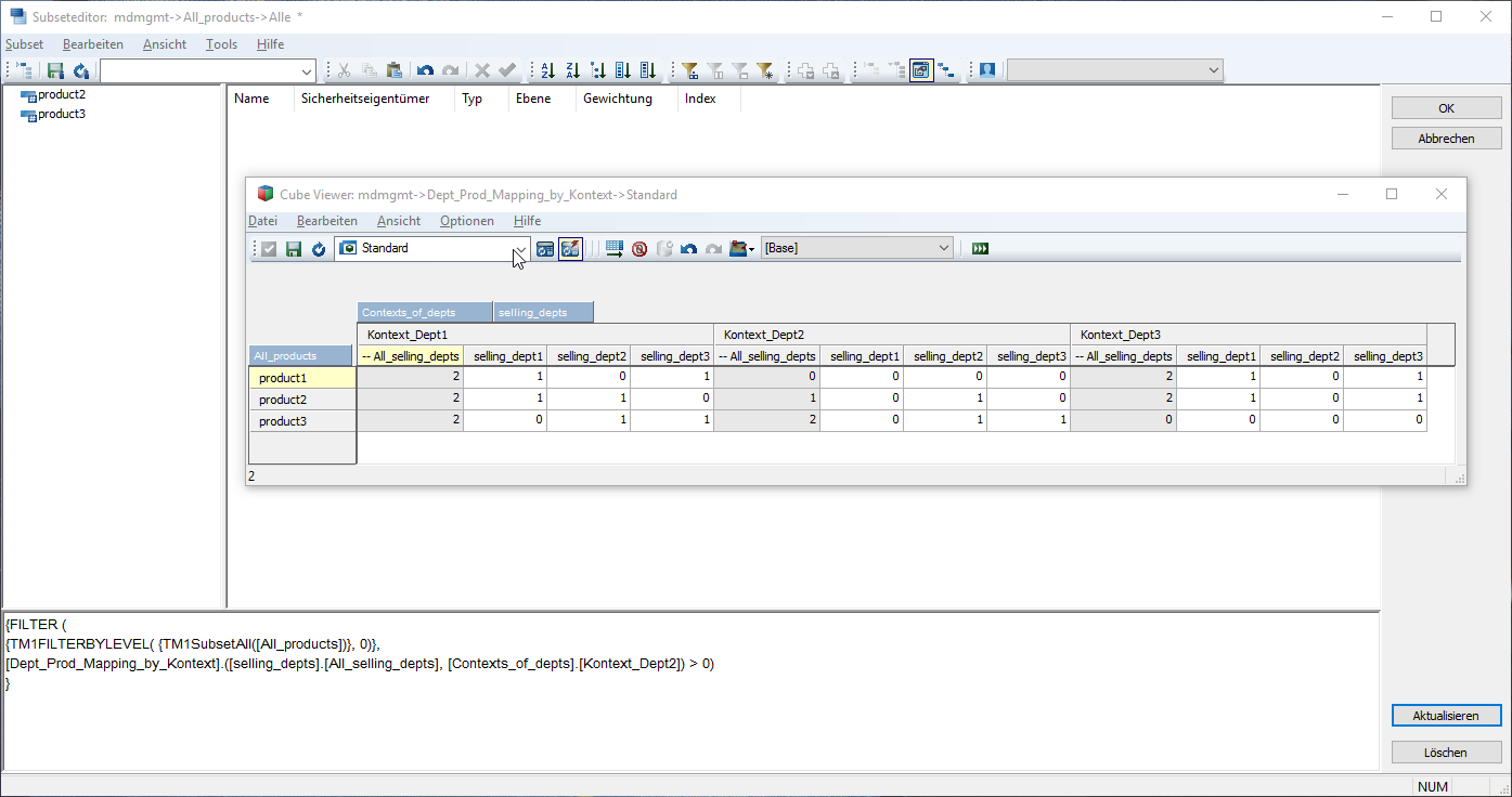

If you need these Dept-2-Products mappings per department, couldn't you create an additional dimension "DeptSlicer" (consisting of elements Dept1, Dept2,...,DeptN)?
Then you just need to incorporate this dimension into your dynamic subset MDX to slice and get the particular mapping that adresses the current department (respectively create the MDX via TI before referencing further on it). SubsetCreatebyMDX combined with 'Expand'-function for the Deptname to refine the MDX-code dynamically could help you doing that dynamic creation of the dept's handcrafted subset.

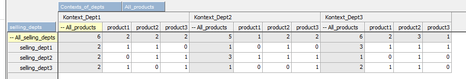

my point was to add an additional dim which has the only function to distinguish the particular versions of dept/product-mappings: -All_products: the products dim
-All_selling_depts: dim of departments, which are those you want to map to a product
-Contexts_of_depts: Filterdim to distinguish the different mappings
We have something similar: n eCommerce brands are selling their own products which they create and produce or import, but also subsets of the products of their peer brands; changing frequently, but need to be retrievable at a particular point in time. For us, this point of time follows the calendar due to defined seasons, but as I don't know your business, I call this criteria more generic 'context-of-dept'...
Stefan

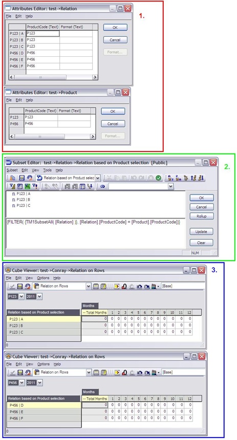

Hi Elessar,
Unfortunately, I don't know if it is possible to create a dynamic subset to present the products per selling department because it is a "many to many" combination. I had to do something similar to that. It is a hard and ugly solution but it will work.
1) Create a Department | Product (concatenating the department and product names) dimension based on your "setup" cube (Dept 1-Product 11; Dept 1-Product 12; Dept 1-Product 13; Dept 2-Product 11; and so on). Try to make less ugly by creating an alias;
2) Create the mdx as the attached image
- DynamicSubset.jpg (123.51 KiB) Viewed 21355 times

I meant this style (amended assigments for demo):
But I think, the solution from tiagoblauth79 is much more elegant using attributes. I will keep this in mind for my own purposes too.
Thanks, Tiago
Thanks, Tiago
